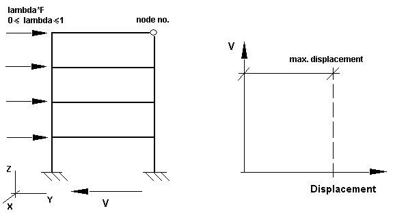

Node number - Number of a structure node belonging to the structure roof (see the figure below)
Direction - Direction of an external factor affecting the structure in the global coordinate system
Maximum displacement - Maximum displacement in the selected structure node.
