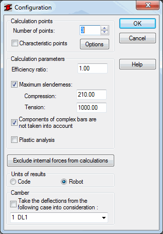

Use the Configuration dialog to define the parameters applied during the verification of a steel member according to the Australian AS 4100 code. Open the dialog clicking the Configuration button in the Calculations dialog. The following dialog displays.
You can specify the following calculation parameters.
If you selected the Components of Complex Bars are not taken into account option, Robot ignores components of complex bars during calculations of these bars.
If you select the Plastic analysis option, Robot analyzes members as specified in Section 4.5 of the code. The general calculation algorithm is based on the elastic analysis; the plastic analysis is possible only in exceptional cases.
Click the Exclude internal forces from calculations button to open the Internal forces not taken into consideration dialog; this dialog box includes options that define the limit values of internal forces (thus the force values that are 'negligible' for a specific section may be disregarded). Also, you can select units for displaying results of the member design. The results are presented in the units used in the indicated steel code, or in the units used in Robot.
At the bottom of the dialog is a list for selecting a load case (dead load); the calculated displacements are treated as structure initial deflections for a selected load case. You must select the Take the deflections from the following case into consideration option then.
