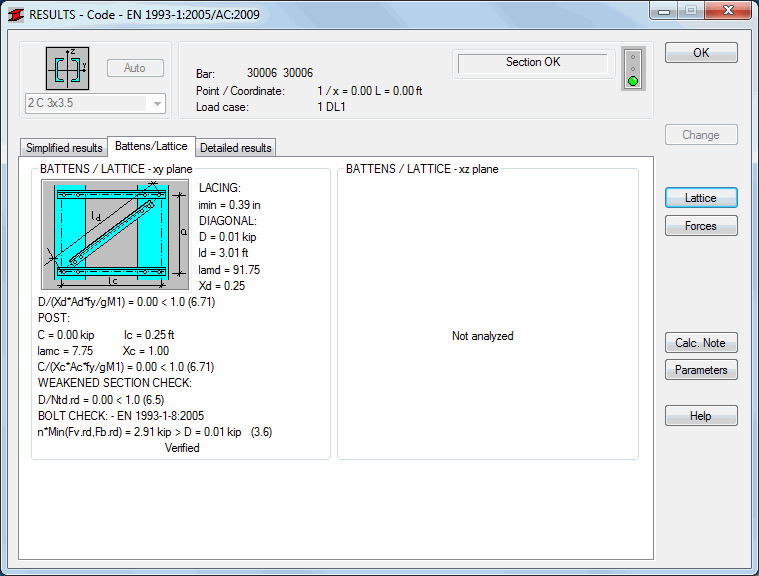

- Two additional tabs are available with the Eurocode3 and Polish code PN:
- Displacements: contains the calculation results for the serviceability limit state.
- Battens / Lattice: contains the verification results for elements connecting chords of complex members).

- Lattice
- Opens the Connections of chords dialog and enable the selection and verification of elements connecting individual member chords.
Note: This option is available when verifying or calculating complex members for Eurocode3 and Polish code PN only.
