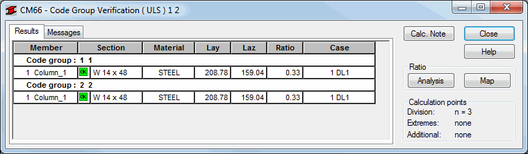

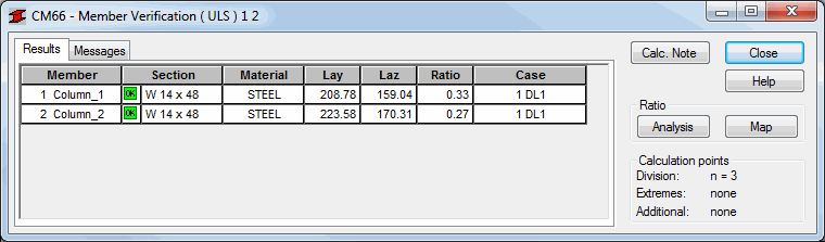

Once calculations have been performed a dialog displays simplified results for the selected type of verification.
The Member Verification and Code Group Verification dialogs are similar.
The Results tab of the Verification dialog displays the results of the verification or design process for steel, timber, or aluminum members, or group of members.
These short results are displayed in a table.
Each row of the table corresponds to a member or group of members according to the list that was defined.
For member group design, three consecutive sections from each family of the selected section group are displayed. The section in the central row meets the code criteria.
The dialog content is the same as the member group design dialog.
DESIGN WITH OPTIMIZATION OPTIONS is a design of each section family that has been selected during group creation. The most optimal profile with respect to the adopted optimization criterion is selected. If the sections of a profile in the current group belong to one family, there is no difference between the results obtained by means of the DESIGN option and those obtained with the DESIGN WITH OPTIMIZATION OPTIONS. Optimization functions as an operation on groups. Therefore, groups of members must be defined before starting the operation of optimization.
