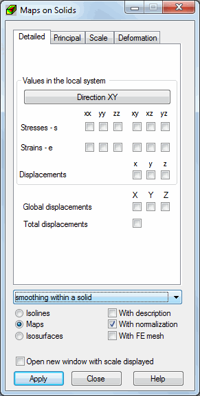

Maps on Solids presents maps or isolines of displacements, stresses and strains obtained during analysis of a volumetric structure. Results can be presented in the form of a map, isoline, isosurface or a map on a cut through a solid. Results are presented on the external face (contour) of a solid, on a cut surface or for selected elements.
The dialog consists of four tabs.
Results for volumetric elements (solids) are presented in tabular or graphical form, including the following.
The lower dialog allows selection of a graphical form for result presentation of volumetric finite elements.
Both maps and isolines may be presented as averaged values between elements.
Results for planar FEs are determined at Gauss's points located inside each element. Results estimated at the common node of adjoining elements may differ slightly in each element, and isolines may not be continuous. To obtain a smooth map of a selected quantity, select the with smoothing option. This results in averaging of the values at a node based on all the values obtained in the elements adjoining the node.
Smoothing may be performed by selecting one of the following.
The lower dialog also contains the following options.
The X and Y axes are local and defined using the Direction option on the Detailed tab. You can define the main direction of the local coordinate system which will be used (x axis). The result values for all elements are calculated to this rotated coordinate system. The direction may be defined by entering any vector defining the main direction when selecting the results for surface FE. The selected vector is then projected onto an element which in the end defines the positioning of the local x-axis. The main vector can not be perpendicular to the element (parallel to the local element z axis). If this direction is selected, all results will be equal to zero.
Typically all elements are located on a cylindrical surface. Initially local x axes are parallel to the global X axis. These axes will be redefined when using the 'main' direction (reference direction) which is parallel to the global Y axis.
