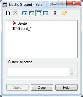

Open the Elastic Ground - Bars, which lets you define elastic ground structure members, using either method:
- Click Geometry menu > Additional Attributes > Bar elastic ground.
- Click

At the top of the Elastic Ground - Bars dialog are the following icons:
- Adds a new type of elastic ground (New type of elastic ground)
- Deletes a type of elastic ground from the active list
, and
- Displays the list of active types of elastic ground as: big icons, small icons, a short list, or full list
- Deletes all types of elastic ground from the active list, which are not in the designed structure
- Opens the Label Manager dialog.
