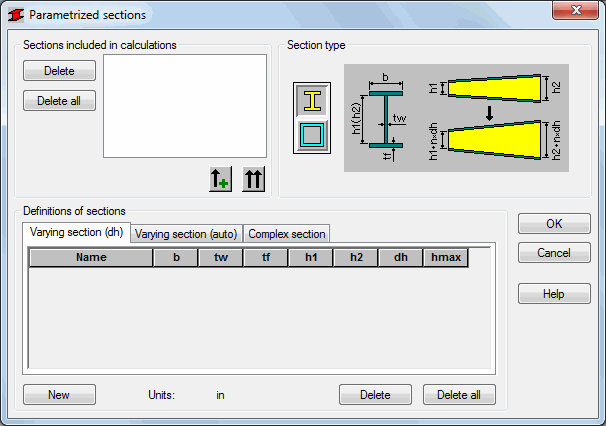

Click the Par. sections button in the Definitions dialog (Groups tab for steel / aluminum sections), the following dialog displays:
The following section types are available in the Section type field, in the upper right-hand corner of the dialog:
When selected, a schematic drawing of the selected section type and the symbol convention for dimensions is displayed. The Definition of sections field defines steel / aluminum section dimensions.
To define a new section:
To delete sections from the list:
There are two types of sections:
The Complex section tab defines complex members.
If the defined sections are to be included in calculations, "move" them to the Sections included in calculations field. There are two ways to include defined sections:
Recognizing sections in calculations:
