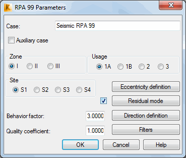

Parameters of a structure seismic analysis depend on a seismic code used during calculations of a structure influenced by seismic impact. Select Algerian seismic code RPA 99 or RPA 99 (2003) in the New Case Definition dialog or click Parameters in the Analysis Type dialog.
To complete the seismic analysis according to the rules given in a code, define the following parameters:
In the lower part of the dialog, the Direction definition, Filters, and Residual mode buttons are located.
The details concerning this structure analysis method can be found in the mentioned code.
