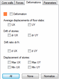

When the Deformation tab is selected on the Diagrams for buildings dialog, the following displays:
Selecting the Deformation option allows presenting deformed structure under the applied load.
The values of the following quantities can be selected in the above dialog.
