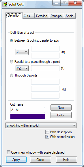

Solid Cuts is used for presenting maps on cuts through solids.
Results are shown on the cut surface.
The dialog consists of five tabs:
Maps on cuts are presented as averaged values between elements.
Smoothing (averaging of values).
Results for planar FEs are determined at Gauss's points located inside each element. Results estimated at the common node of adjoining elements may differ slightly in each element, and isolines may not be continuous. To obtain a smooth map of a selected quantity, select the with smoothing option. This results in averaging of the values at a node based on all the values obtained in the elements adjoining the node.
Smoothing can be carried out by choosing one of the following.
The lower dialog contains the following additional options.
