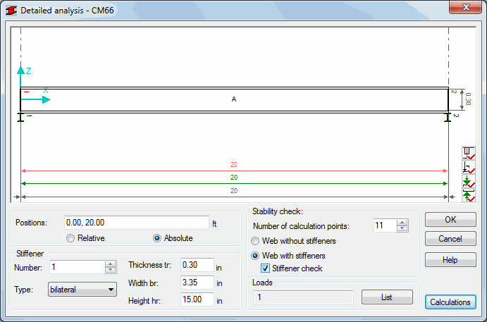

Access the detailed analysis for the French steel code CM66, by clicking the Detailed button in the dialog with detailed results .

The top part of the dialog presents a schematic drawing of a member including its dimensions; the bottom right corner of the drawing shows the icons listed below:
Turns on/off display of stiffeners, stiffener numbers, panel numbers and distances between stiffeners. |
Turns on/off display of forces acting on the upper flange of a member, their numbers and distances between them. |
Turns on/off display of forces acting on the lower flange of a member, their numbers and distances between them. |
Turns on/off display of supports/adjoining bars positioned on the upper flange of a member, their numbers and distances between them. |
Turns on/off display of supports/adjoining bars positioned on the lower flange of a member, their numbers and distances between them. |

When analyzing a beam, if a support that has already been defined, is detected, it will be drawn automatically in a drawing. If no supports are defined (you are considering a spandrel beam of a frame, for example), a vertical bar (which potentially may act as a support) may adjoin an analyzed beam instead. The points where adjoining (subordinate) beams are positioned are automatically recognized which transfer loads onto the analyzed beam. Positions of concentrated forces acting on the beam are also recognized automatically.
Calculations are started after clicking the Calculations button.
The following options are in the lower part of the dialog:
Stiffeners are defined automatically after running the Detailed analysis at the following locations on the bar:
Parameters of the stiffeners that are defined automatically may be changed: all the stiffeners defined automatically may be freely modified, added or deleted. Stiffener positions are shown in the Positions edit field; a stiffener position may be defined in real coordinates or in relative coordinates (with respect to bar length).
By default, the following stiffener parameters are set:
It is assumed by default that length of the beam equals the distance between the theoretical axes of members.
