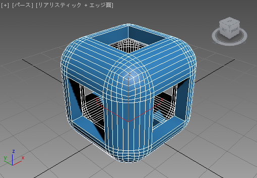

b = box()  --create a default Box
c = chamfer() --create a Chamfer modifier
addModifier b c --add the Chamfer to the Box
c.amount = 5.0 --set the Amount to 5.0
c.segments = 5 --set the Segments to 5
c.tension = 0.5 --set the Tension to 0.5 to curve the new faces
c.openChamfer = true --remove the new faces
c.Invert = true --invert to remove the old faces instead
s = shell() --create a Shell modifier
s.outerAmount = 4.0 --set its Outer Amount (Thickness) to 4.0
addModifier b s --add the Shell modifier to the Box above the Chamfer modifier
結果:

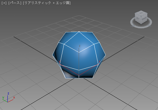

c.amount = 2.0 --set the Amount to 2.0
c.segments = 2 --set the Segments to 2
c.tension = 0.0 --set the Tension to 0.0 to add new edges without changing the existing shape
t = turboSmooth() --create a TurboSmooth modifier
addModifier b t --add the TurboSmooth modifier to the Box
--Try turning off the Chamfer modifier to see the difference (second image)...
結果
