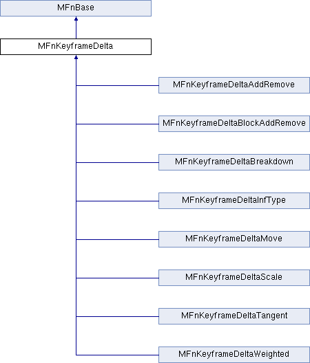

+ Inheritance diagram for MFnKeyframeDelta:
