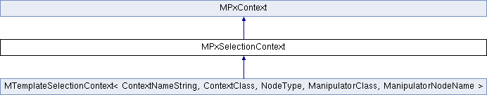

Class Description
+ Inheritance diagram for MPxSelectionContext:
Public Member Functions
