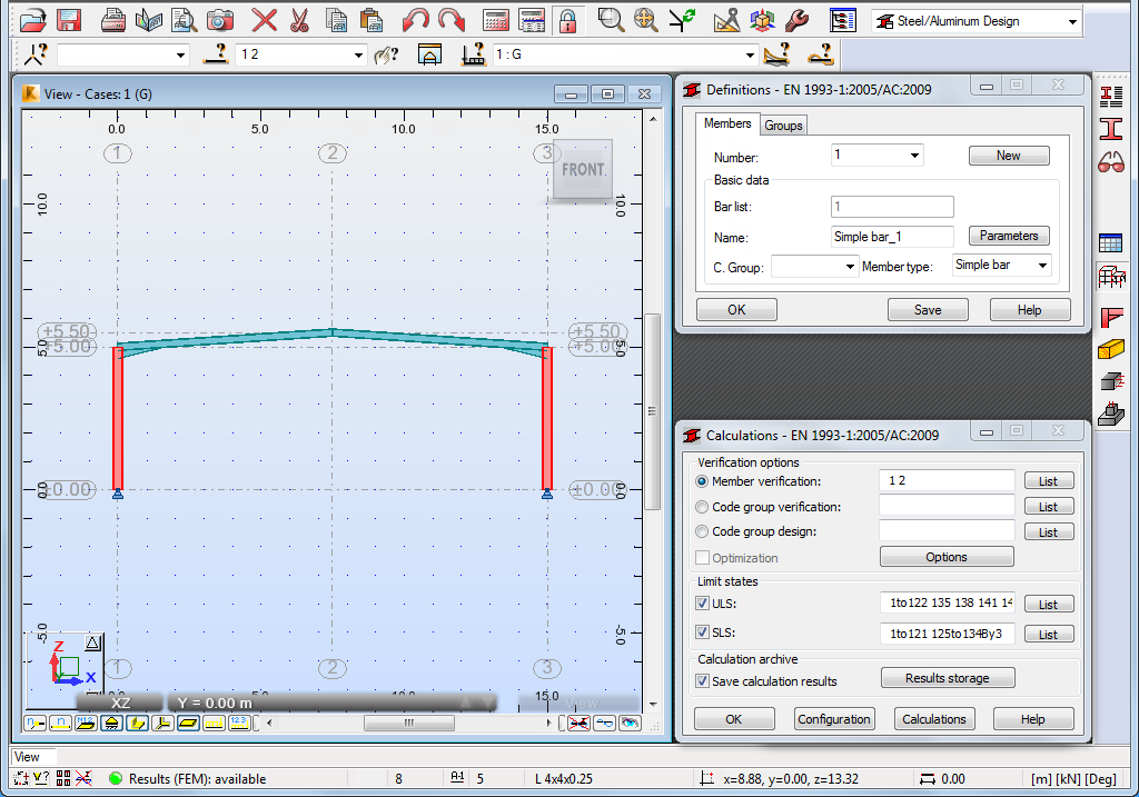

  2. In the Standard toolbar, in the Layout drop-down menu, select Steel Design and then select Steel/Aluminum Design as shown below.
  3. The layout of the screen resets (as shown below) to display dialog boxes for the Definitions and Calculations that are related to the selected code. Having these already open makes the rest of the process of structural verification much easier.
