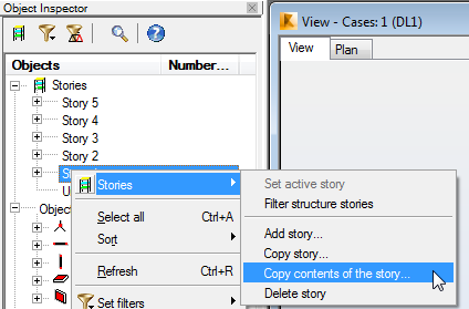

tab. All of the elements that you have created can be copied to the other stories.
In the Object Inspector, right-click on Story 1 and select
Stories
Copy contents of the story…
as shown below.
Note:
If you did not have additional Stories in the project, you could use
Copy story…
and have the software create the story and copy the contents.

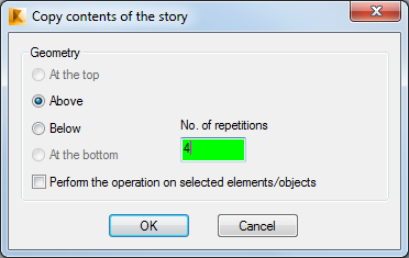

In the Copy contents of a story dialog box, set the
Geometry
to
Above
and the
No. of repetitions
to
4
as shown below.
Click
OK

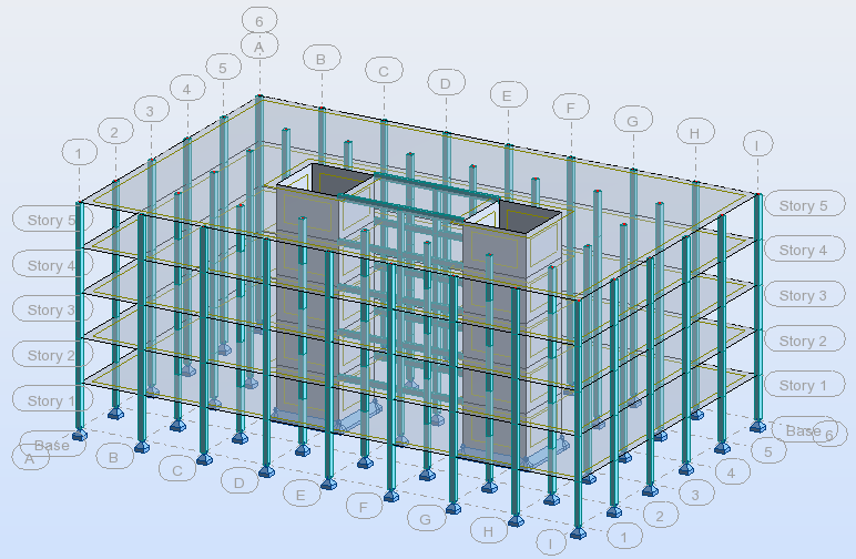

The contents of Story 1 are copied to the other stories as shown below.
