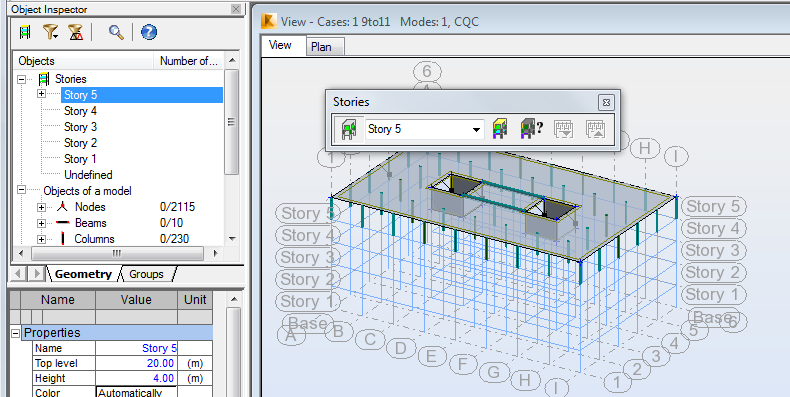

  1. In the Object Inspector, double-click on Story 5. The view changes to only display the elements of Story 5 as shown below.

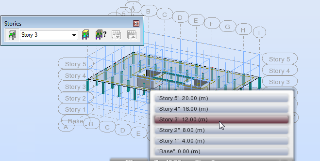

    Note: You can select the story in which you want to work using the Object Inspector or from the Stories toolbar, or the pop-up list at the bottom of the screen as shown below. If you test this, ensure that you go back to Story 5 before continuing with the steps.

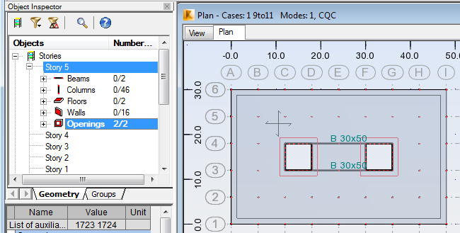

  3. In the Object Inspector, expand Story 5 and select Openings as shown below.
  4. These openings are no longer needed. Press <Delete> to remove them.

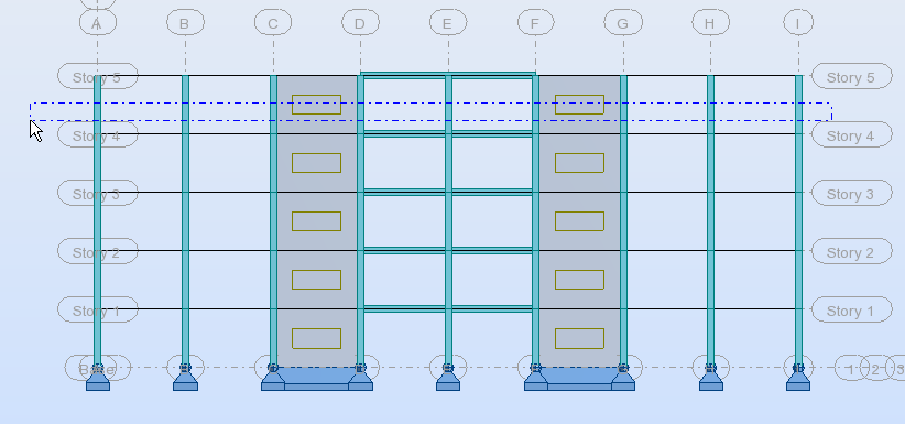

  9. Select all of the columns in Story 5 by drawing a crossing window as shown below.

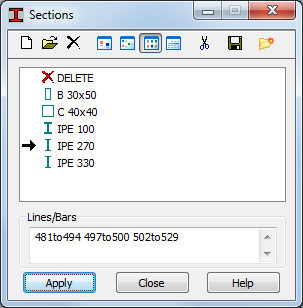

  14. In the Structure Definition toolbar that displays, click (Bar Sections).
  15. In the Sections dialog box, select IPE 270 as shown below and click Apply.
    Note: If the IPE 270 section does not display, in the Sections dialog box, click (New Section). In the New Section dialog box, on the Standard tab, set the Family to IPE and the Section to IPE 270. Add IPE 330 if needed. Close the dialog box.
  16. Close the dialog box.

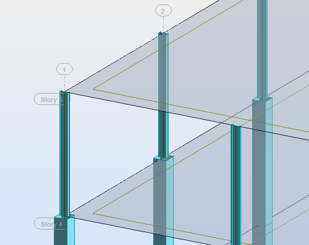

  17. Switch to the 3D view and zoom in to note how the columns have changed as shown below.
