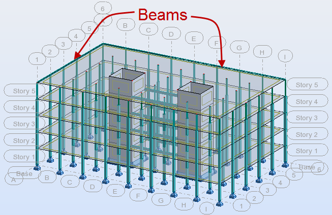

  3. In the Structural Design toolbar, click (Beam).
  4. In the Beam dialog box, set the Section type to Steel beam and the Section to IPE 270.
  5. Zoom out and draw 2 beams as shown below.

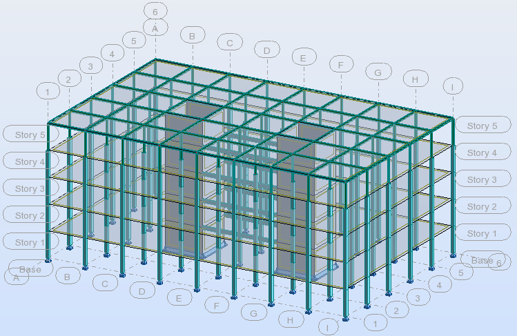

  6. Switch to the Plan view.
  7. Select the long beam and copy it to the other grids. Repeat the process with the shorter beam. The final building should look similar to the one shown below.
