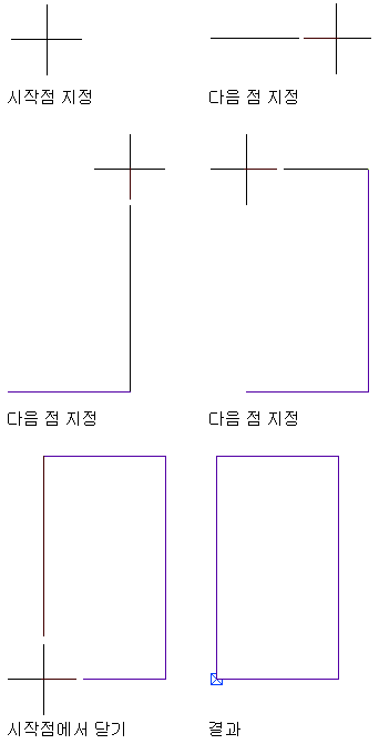

You add the slab or roof slab by specifying points to define its perimeter as follows:
  1. Open the Design tool palette, and select the Slab tool or the Roof Slab tool.
    Note: Alternatively, you can click Home tabBuild panelRoof Slab drop-downRoof Slab Find , or Home tab Build panel Roof Slab drop-down Slab . Find
  2. Specify the start point of the slab or roof slab.
  3. Specify a second point to define the first edge (baseline) of the slab.
  4. Specify further points to finish defining the perimeter:
    If you want to… Then…
    close the perimeter by drawing two edges that meet at a right angle specify a point in the direction in which the perimeter is to close; then enter o (for Ortho). The edge is extended until it meets another edge perpendicular to the first edge.
    close the perimeter by adding an edge from the previous point to the start point of the baseline enter c (for Close).
  5. Press Enter.
Drawing a slab
