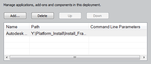

    A table is displayed in which to manage the additional software.
  3. Above the table, click Add, browse to the file location, and then click a file.
    The file name and path are added to the management table. Repeat this step to add more files. Buttons for deleting files and moving them up or down in the list become active when the table contains at least two files. Horizontal and vertical scroll bars are added when the table extends beyond the window.
