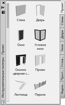

Tool palette containing a curtain wall tool
The following palettes contain one or more curtain wall tools:
| Tool Palette | Curtain Wall Tools |
| Design palette in the Design palette group | a tool for the Standard curtain wall style and default settings for other curtain wall properties |
| Design Tool Catalog in Content Browser | a package of curtain wall and curtain wall unit tools. |
| custom tool palettes created by your CAD manager | tools with curtain wall styles and properties that your CAD manager customized for your projects or office standards. |
