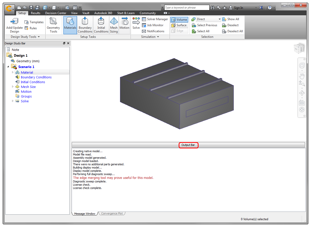

1. To open up some additional screen space, collapse the Output bar by clicking the Output Bar button:

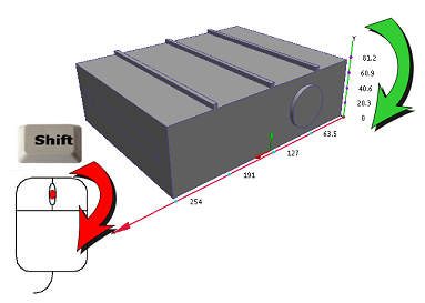

2. To rotate the model, press Shift and the middle mouse button, and move the mouse:

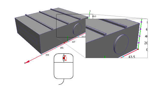

3. To zoom, roll the scroll wheel:
4. To pan (move), hold the middle mouse button, and move the mouse:

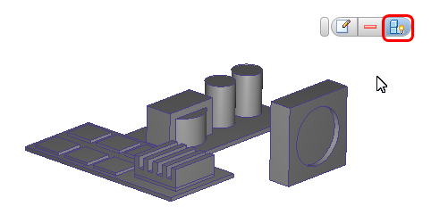

5. To see the internal components, hide the casing part and then the air part. To do this, position the curser over each, press Ctrl and the middle mouse button:
Hide casing:
Hide air:
An alternative way to hide parts is to left click on the part, and click the Hide icon from the context toolbar:
Now we can see the chips, boards, fan, and other components!

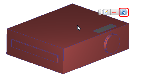

6. To show all the parts, press Ctrl and middle click off the model in the graphics window:
An alternative way to show all parts is to left click off the model, and click the Show All icon from the toolbar:
