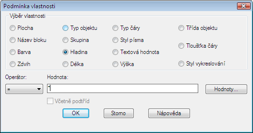

To preview drawing objects using a property query
Select Layer as the property condition. Only objects on the layers you specify are added to the map.

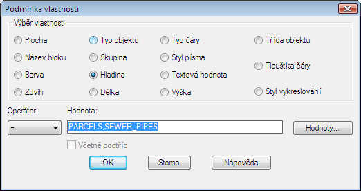

Specify which layers to use to determine the objects that are added.
Preview mode displays the objects without actually creating them in your drawing.
. The objects on the PARCELS and SEWER_PIPES layers are displayed in the drawing window. They are not created in the drawing because you used the Preview Query Mode.
The objects that match the criteria appear in the drawing.
Only the parcels (polygons with black outlines) and the sewer pipes (green lines) are displayed in the drawing area.
