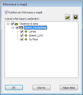

To set publishing options
When you select Street_Centerlines, everything under Street_Centerlines is automatically selected.
The DWF Publish operation uses the XML file.
