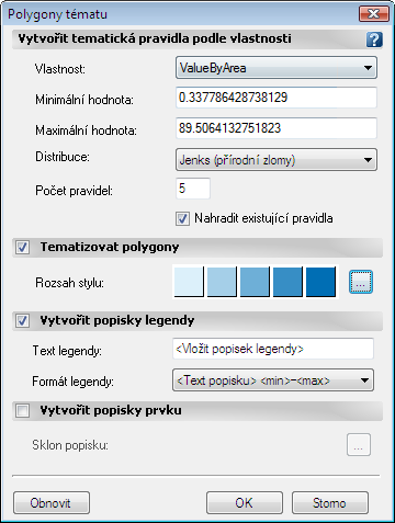

A theme varies the display of individual features based on data values. For example, if you theme by parcel value, less expensive parcels can be a lighter color while more expensive ones are a darker shade.
In this exercise, you create a theme based on the calculated property you defined for ValueByArea.
To create a theme using a calculated property
The Jenks distribution method groups ranges of features at their natural breaks so that features with similar values are grouped. This method shows the natural groupings in the data, rather than creating arbitrary breaking points.
The Style Range is a gradient between two colors you specify.
Leave the Style Editor open for the next exercise.
