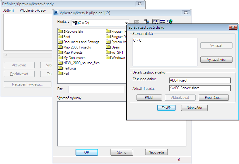

A drive alias allows multiple users to use the same pathname for a drawing stored on a shared drive. It allows each user to map that drive to a different drive letter.
If you are connected to the Internet, play the video to see how to define a drive alias. The steps for this procedure are listed below the video. |
To define a drive alias
Add Drawing Data
Attach Source Drawings. The name must use only alphanumeric characters (including hyphen and underscore), contain no spaces or colons, and start with a character. For example, you can call the alias TutorialData.
In the Drive Alias Administration dialog box, specify a name for the alias and the actual path it represents.
In this example, use the path to the folder where you copied your tutorial files.
The drawing location is now mapped to your drive alias. You can now open drawings in that folder without defining any further aliases.
