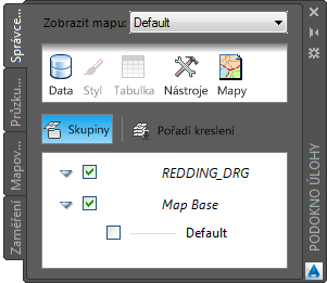

The Display Manager tab of the Task pane controls the styling and display of items in your map. The layers in the Display Manager are different from AutoCAD layers, but they allow you to do similar things. For example, you can hide and show Display Manager layers, even if those layers contain raster images rather than drawing objects.
In this lesson, you add a raster image to a Display Manager layer. You rename and hide the raster image layer.
If you are connected to the Internet, play the video to see how to add a raster image to Display Manager. The steps for this procedure are listed below the video. |
To add an image to a new Display Manager layer
Raster Image.
In the Display Manager, REDDING_DRG is now listed as a layer.
Save.
The raster image is no longer displayed in the drawing.
You adjusted the image appearance in your map without changing the image file itself. You added the image to a layer in Display Manager, where you can hide and show it easily.
