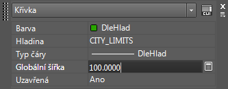

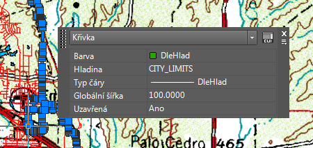

To change the width of a polyline
The green polyline represents the city limits.
Use the zoom commands on the View tab to zoom out to find the green polyline and then zoom in to select it.
If the Quick Properties panel is not displayed, right-click anywhere in the drawing and select Quick Properties.
You can edit values in the Quick Properties window.
The polyline displays at the new width.
