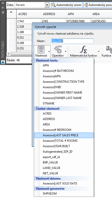

Now you have joined owner data to the Parcels layer and saved the result to a new data store. You can use the combined information to create a calculated property. The calculated property is the result of an expression: in this case, the last sales price divided by the area.
To create a calculated property using joined data
Create A Calculation.
All properties for this feature class are listed in the Property list.
Area2D. This option calculates the area of a polygon.
Every spatial feature has a geometry property that you can use to calculate area or length.
Scroll to the right in the Data Table to see the new field. It is gray, to indicate that it is a calculated property and cannot be edited.
