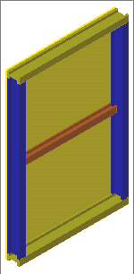

| Name : | block_Ex03 | |
| Design : | acDrawingDocument | |
| Name | Typ | Formel |
| panelMajor | Zahl | 48 |
| panelMinor | Zahl | 32 |
| panelDepth | Zahl | 4 |
| sectionMajor | Zahl | panelDepth - panelLength |
| sectionMinor | Zahl | sectionMajor / 2 |
| Untergeordneter Name : | panel | |
| Untergeordnetes Design : | :Block | |
| Name | Typ | Angegeben |
| width | Zahl | panelMinor |
| height | Zahl | panelMajor |
| length | Zahl | 0.5 |
| color | Zeichenfolge | "dandelion" |
| Untergeordneter Name : | sideTop | |
| width | Zahl | panel.width |
| height | Zahl | sectionMinor |
| length | Zahl | sectionMajor |
| v011 | Punkt | panel.v001 |
| color | Zeichenfolge | "olive green" |
| Untergeordneter Name : | sideBottom | |
| v011 | Punkt | panel.v000 |
| Untergeordneter Name : | sideLeft | |
| width | Zahl | panel.height - 2 * sectionMinor |
| eTopLeft | Punkt | sideTop.eBottomLeft |
| color | Zeichenfolge | "navy blue" |
| Untergeordneter Name : | sideRight | |
| eTopRight | Punkt | sideTop.eBottomRight |
| Untergeordneter Name : | middle | |
| eLeftRear | Punkt | sideLeft.eRightRear |
| color | Zeichenfolge | "copper" |

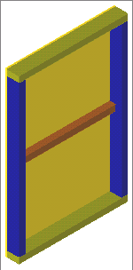

| Name : | block_Ex04 | |
| Untergeordnetes Design : | :block_Ex02 | |
| width | Zahl | sectionMinor |
| height | Zahl | sectionMajor |
| length | Zahl | panel.width |
| matingPoint | Punkt | panel.v001 |
| localMatingPointName | Name | :v001 |
| xDirection | Vektor | -unitZ |
| yDirection | Vektor | unitX |
| matingPoint | Punkt | panel.v000 |
| localMatingPointName | Name | :v000 |
| length | Zahl | panel.height - 2 * sectionMinor |
| matingPoint | Punkt | sideTop.eRightFront |
| localMatingPointName | Name | :eLeftRear |
| xDirection | Vektor | unitX |
| yDirection | Vektor | unitZ |
| matingPoint | Punkt | sideTop.eRightRear |
| localMatingPointName | Name | :eRightRear |
| length | Zahl | panel.width - 2 * sectionMinor |
| matingPoint | Punkt | sideLeft.eBottomRight |
| localMatingPointName | Name | :eBottomFront |
