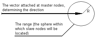

- Specify the parameters for slave nodes: connection vector (determining a direction, orientation and length) and range (a radius of the R sphere). See the following image. All nodes located in the defined range are slave nodes to the rigid link.
