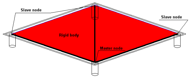

The use of rigid links can be illustrated by defining a floor which is rigid in its plane, whereas, in the direction perpendicular to the floor plane, it is pliant. A rigid link is defined as a rigid membrane linked with a master node, to which slave nodes with a selected set of degrees of freedom are attached. (To achieve full rigidity, all degrees of freedom for the slave nodes should be selected.) When using rigid links, it is possible to model a membrane (see the following image) - the directions UZ RX RY RZ in the slave nodes are released.

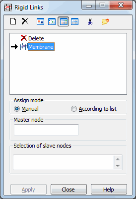

Open the Rigid Links dialog for defining the rigid links in the structure, using either method:
The Rigid Links dialog box has the following elements:
At the top of the dialog are the following:
