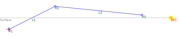

In the following example,
AP1 is an auxiliary that is drawn on the Surface at a slope from P2. P3 and L2 are drawn an interpolated distance between P2 and AP1.
