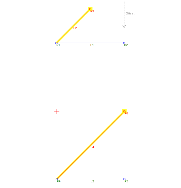

To see examples of how this geometry element is used, open the following Sample PKT file:
Point Angle and Delta X.pkt
The example PKT contains two Angle and Delta X point examples. Each Point Geometry Type is defined by Angle and Delta X parameter values, and the Delta X value may be overridden by a specified offset target parameter. The same Delta X value is used in both examples. The Static Delta X (P1 to P3) example applies the value, but the Offset Target example uses an offset target parameter that overrides the static Delta X value.
In the Flowchart, each example is constructed in a separate sequence. To review the parameters, select the Angle and Delta X point in the appropriate sequence, and then see the Point Geometry Properties section of the Properties panel.
