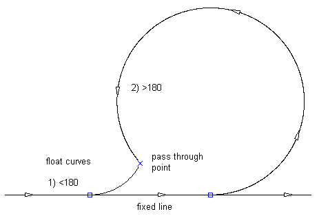

The following illustration shows a floating curve attached to a fixed line and two possible solutions for a given radius and point:

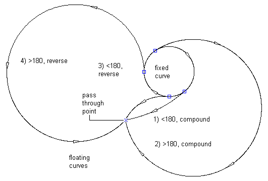

The following illustration shows a floating compound curve attached to a curve and four possible solutions for a given radius and pass-through point. The illustration also shows variables for greater than and less than 180 degrees and compound and reverse variables:
