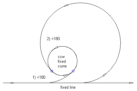

The following illustration shows a free curve fillet between two fixed lines. There are two solutions based on the included angle of the curve:

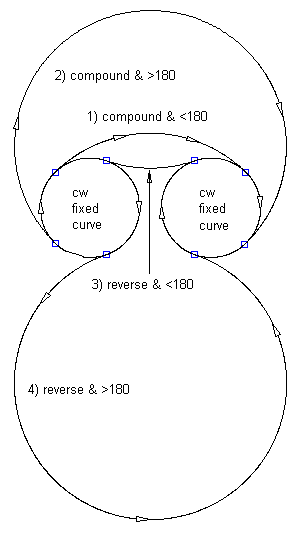

The following illustration shows a free curve fillet between two fixed clockwise curves:

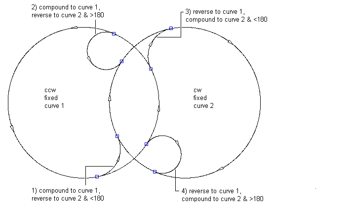

The following illustration shows a free curve fillet between a fixed clockwise curve and a fixed counter-clockwise curve:

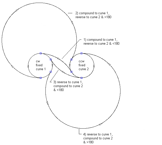

The following illustration shows a free curve fillet between an overlapping clockwise curve and a counter-clockwise curve:
