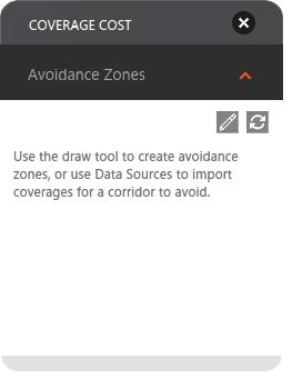

  4. Click Draw Avoidance Zones to display the Cost Zones asset card.
  5. Click in the Cost Zones asset card to sketch a polygonal avoidance area. Double click to finish.
