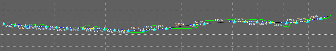

A rough profile before Profile Optimisation

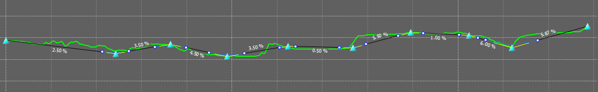

A profile after Profile Optimisation
