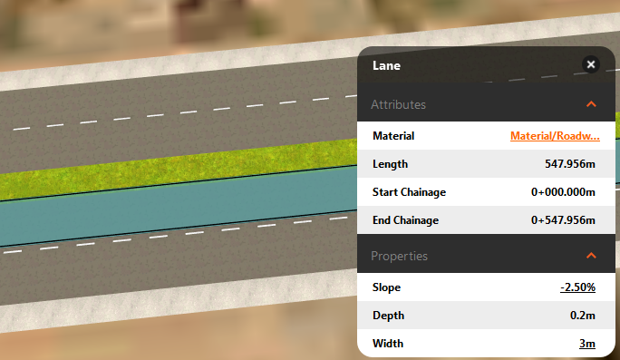

About Component Roads (Preview)
Component roads enable you to add, delete and modify every component and assembly that makes up a design road. Rather than applying styles to an entire road, you can now design roads in the context of the surrounding scene. For example, add lanes and kerbs where needed. Create and save road assemblies for re-use.
To work with component roads, activate the Road Component Model preview from the Preview section of InfraWorks 360 Home. For more information, see To work with component roads (preview).
