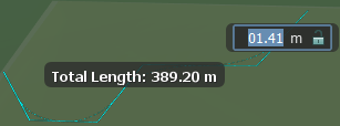

  4. Sketch the boundary on the terrain.
    Action Result Visual
    Click points to create a boundary for the pond or lake. Double-click the last point to finish creating the region.
    The boundary is filled with the water style you selected.
    Define a linear path for the river. Double-click the last point to finish creating the line.
    A linear water feature uses the water style you selected. A buffer surrounds the water on either side.
