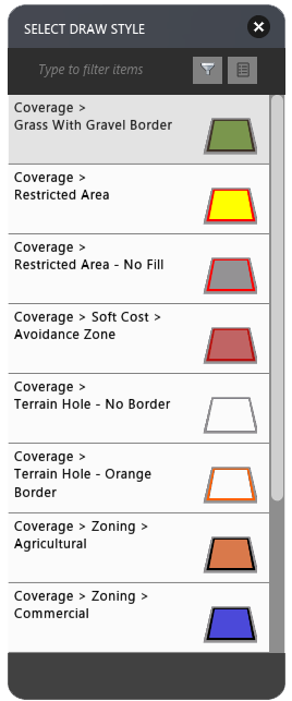

The example below shows the Select Draw Style catalog that appears when you choose to draw a coverage area by clicking , the Sketch Coverages tool. If you want to use different styles than what are shown in the Select Draw Style catalogue, you can create and edit new styles for any feature type using the Style Palette. See About editing styles for more information.
