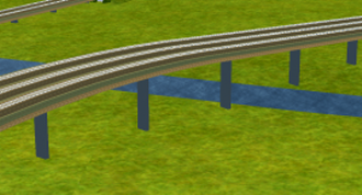

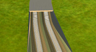

A railway unit with two railway tracks sharing a tunnel A railway unit with three railway tracks sharing a bridge structure
