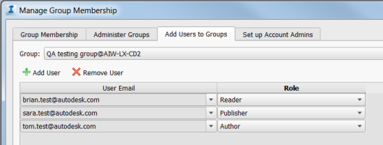

To add users to a group and assign roles
  1. On InfraWorks 360 Home, click to display a horizontal menu.
  2. Click .
  3. In the Manage Group Membership dialogue box, click Add Users to Groups.
  4. Select the correct Group from the pull-down menu.
  5. Click .
  6. Enter valid user email addresses.
  7. Assign a Role for each user. (See About Roles in Groups and About Collaboration.)
    Note: You can not assign the Administrator role to a member from this tab. You do so from Set up Account Admins. See To add Admin users. Also. it's good practice to limit the roles of Publishers, because a Publisher, like an Administrator, can delete cloud models and prepare them for viewing in a browser.
  8. Click Done to send an email invitation to each new user.
    A notice is displayed on InfraWorks 360 Home.
    Users must accept the invitation to join the group.
