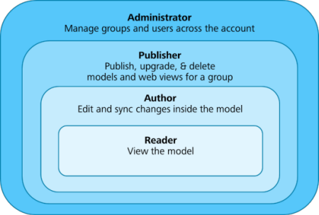

You can belong to more than one group. You can have the same or a different role in different groups. See About Roles in Groups.
A collaboration group Admin sets up groups, manages membership and assigns roles to each member.
Publishers as well as Admins manage shared models, including preparing a model for viewing in a browser.
