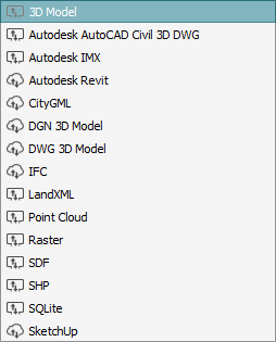

  7. Click in the Data Sources panel and choose 3D Model.
  8. Navigate to the DAE file you saved to your local system or mapped network drive and click Open.

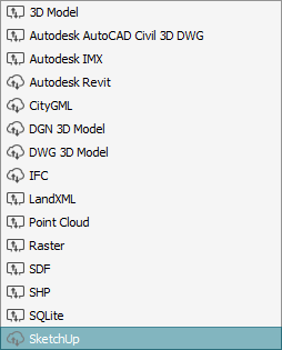

  3. Open the Data Sources panel and click , then choose SketchUp from the drop-down menu.
  4. Navigate to the SKP model file and click Open.
