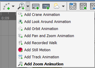

  1. In Storyboard Creator, display the pull-down menu for Add a new Zoom Animation.
  2. Select type of animation:
    • — Crane

    • — Zoom
      The camera moves in or out from the original position.
  3. Enter a name for the animation and indicate its duration.
