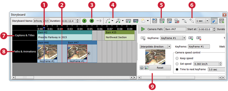

Storyboard Creator opens in the bottom portion of the model window. You can adjust the size and position of the panel window.
- Play head indicator (the blue line) sets the starting point for playback.
- Marker (red arrow) indicates the insertion point for new elements.
- Playback controls play the entire storyboard, starting from the play head indicator (blue line). Individual elements have their own playback controls.
- Storyboard tool bar contains controls to create elements and manage storyboards.
- Import and export storyboards.
- Zoom in and out of the storyboard and specify the zoom resolution. You can also zoom the storyboard extents.
- Captions and tiles appear in the top track.
- Camera paths and animations appear in the bottom track.
- Settings for the selected item appear to the right.
For details, see To create a storyboard.
