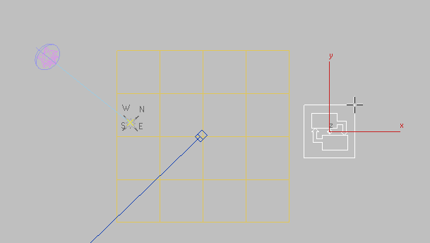

- On the Object Type rollout, click PF Source to activate it. In the Top viewport, drag anywhere outside the plane to place the Particle Flow source icon.
The size and location of the source icon is not important, since the particles will be generated from the plane object.
- Right-click to end object creation.

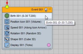

Initially, the system contains two events: the source that you just created, and a default Event 001.
- In Event 001, click the Birth 001 operator to highlight it.
On the right of Particle View, the Birth 001 rollout displays parameters that relate to particle creation. The Emit Start and Emit Stop spinners indicate that particle generation will start at frame 0 and end at frame 30. The Amount spinner indicates that 200 particles will be generated by the system.

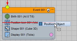

- The “depot” is the list of operators and tests that appears at the bottom of the Particle View window. Drag a Position Object operator from the depot and in Event 001, drop it directly over the Position Icon 001 operator.
3ds Max displays a red line to indicate you are replacing the original operator with the new one.
- Click the new Position Object 001 operator to highlight it. In the Position Object 001 rollout
Emitter Objects group, click Add. In any viewport, click the Plane01 object.
Before, particles were emitted from the particle source icon. Now, particles are emitted from the Plane01 object: You can see them scattered about the plane’s surface.

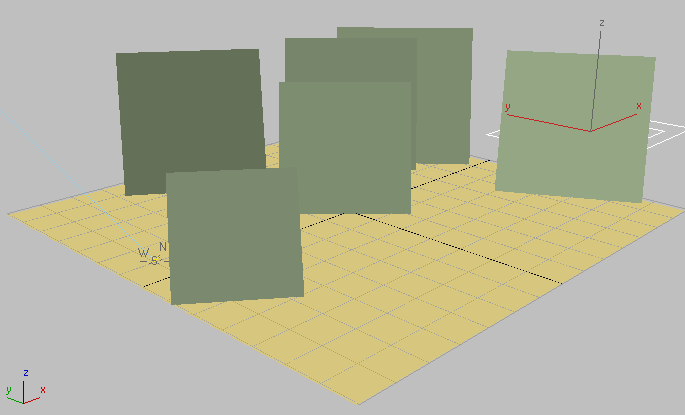

- From the depot, drag a Shape Facing operator directly over the Shape 001 operator to replace it.
- Click the Shape Facing 001 operator to highlight it. In the Size/Width group, make sure In World Space is chosen, then change the value of Units to 40.0, and press Enter.
This value increases the size of the particles.
- In the Look At Camera/Object group, click the button labeled “None” and in any viewport, click the Camera01 object. After you have done so, turn on Use Parallel Direction.
The particles, which previously lay flat on the plane emitter, now face the direction of the Camera01 object.
Note: To refresh the scene properly, you might need to adjust your view in the Camera01 viewport, using any viewport navigation control.
- On the Shape Facing rollout, open the Pivot At list, and choose Bottom.
- At the bottom of the Size/Width group, change the value of Variation % to 25.0.
This creates a range of particle sizes. The tree images mapped onto each particle will also vary in size.

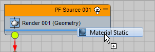

- From the depot, drag a Material Static operator to the PF Source 001 event. Drop it just below the Render 001 operator. A blue line indicates the point of insertion.
Note: You are defining the material at the PF Source 001 level because you want all the trees to share the same material throughout the particle life span. If you wanted to assign the trees different materials based on a specific particle event, you would have dragged the Material Static operator to the appropriate event box.

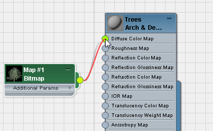

- Drag a Bitmap entry from the Browser into the active View.
3ds Max opens a file dialog. Navigate to
\sceneassets\images
and choose
elm_summer.tif.
- Wire the new Bitmap node to the Diffuse Color Map socket of the Trees material.

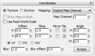

- On the Coordinates rollout, turn off Use Real-World Scale if it is on, and make sure Tiling is set to 1.0 for U and V.
This step ensures that the image area matches the size of the particle.

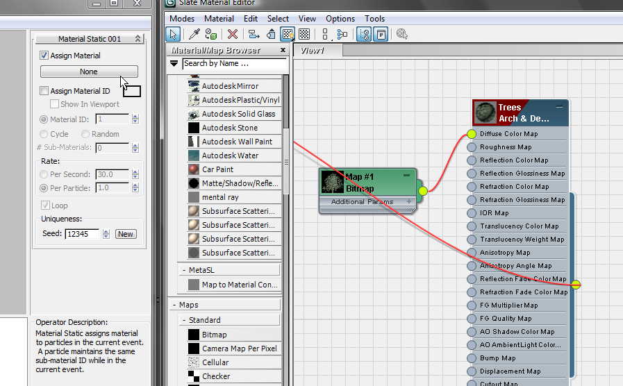

- Move Particle View and the Slate Material Editor so you can see both windows. In Particle View, highlight the Material Static 001 operator, then drag from the output socket of the Trees material node, and in Particle View, drop the material on the Assign Material button (initially labeled “None”). When 3ds Max asks whether to use a copy or an instance, make sure Instance is chosen, then click OK.
Tip: If the tree maps don’t appear in the shaded viewport right away, turn off Assign Material and then turn it back on.
Now the tree map is now applied to all particles in the scene. Their background remains visible: You still need to make them cutouts by using the alpha-channel information.

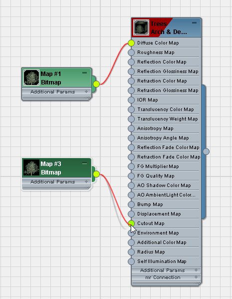

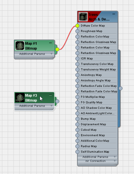

- In the Slate Material Editor, Shift+drag the Bitmap node to make a copy of it.
- Wire the new Bitmap copy to the Cutout Map socket of the Trees material node.
- Double-click the new Bitmap node so you can see the map parameters.
- On the Bitmap Parameters rollout, in the Mono Channel Output group, choose Alpha, and then in the RGB Channel Output group, choose Alpha As Gray.
Now the background of the tree bitmap no longer appears.

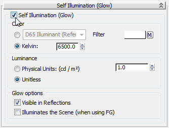

- In the Slate Material Editor, wire the original Bitmap node (the one you are using for colors, not for the alpha channel) to the Self-Illumination Map socket of the Trees material node.
- Double-click the Trees material node so you can see the material parameters.
- On the Self Illumination (Glow) rollout, turn on Self Illumination.
At this point, the self-illumination has no real effect, because the default Luminance values are overpowered by the Daylight system exposure value set for your exterior scene.

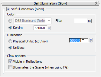

- In the Luminance group, leave Unitless chosen, and enter a value of 5000.0.
Close the Slate Material Editor.
- Render the Camera01 viewport.
Particle trees with self illumination added
Now the self-illumination of the trees is apparent.
