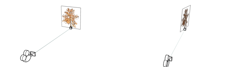

Because the tree image is two-dimensional, it can be seen properly only when it directly faces the camera. If seen from an angle, it loses its realism.
Left: Particle tree facing camera
Right: Particle tree at oblique camera angle
For this reason, the flat plane on which the image is mapped must be continuously re-oriented toward the camera as the camera moves around the scene.
Particle tree continuously faces the camera

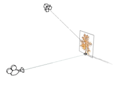

Another consideration is how your two-dimensional particle trees cast shadows. If the light source (usually the sun) does not directly face the billboard plane, the tree will cast an unrealistic oblique shadow, as shown in the next illustration.
Light source causes the particle tree to cast a shadow at an oblique angle

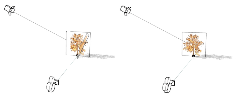

Therefore, you must generate a second set of particle tree planes. The first set should show the tree and no shadow, while the second set should show a shadow and no tree.
Left: Second particle tree oriented toward the light source, with its shadow visible
Right: Second particle tree hidden, with only its shadow visible
The visible tree planes are oriented to continually face the camera, while the shadow-only tree planes continually face the light source. You define the tree and shadow orientation in the particle system parameter settings.

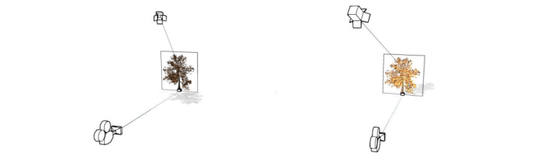

You should also introduce a degree of self illumination to the particle-based trees you generate. Otherwise, if the light source is behind the object in camera view, as shown in the next illustration, the object can appear darker that it should.
Left: Camera view of backlit particle tree with no self-illumination
Right: Camera view of particle tree illuminated directly by light source
