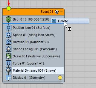

  3. From the depot, drag a Shape Facing operator, and drop it on top of the Shape operator, to replace the Shape operator with Shape Facing.
    Unlike the blue line that appears when you add an operator by dropping the operator between two others, the line for replacing an operator appears red.

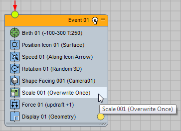

Set the particles to grow over time:
    The smoke particles should grow over time: As the smoke rises, it also disperses. To model this, you use a Scale operator.
  1. Drag a Scale operator from the depot to Event 01, and drop it between the Shape Facing and Force operators.
  2. Click the Scale operator to highlight it.
  3. In the Scale parameters, choose Relative Successive from the Type drop-down list.
  4. Make sure Constrain Proportions is turned on, then change the value of Scale Factor X % to 100.2.
    Because Constrain Proportions is on, the Y % and Z % factors update to 100.2 as well.
    The factor by which the particles grow doesn’t need to be great. Even two-tenths of a percent increase at each frame adds up quickly.
  5. Hide Particle View (6) and drag the time slider.
    The particles increase in size as they rise.

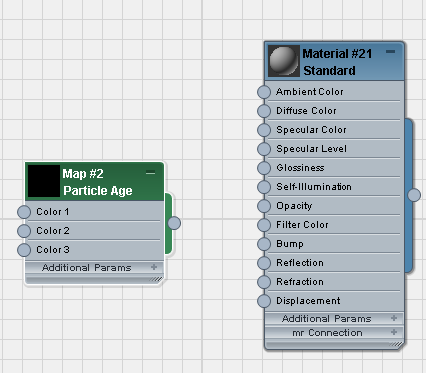

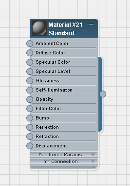

  2. In the Material/Map Browser panel on the left, locate Materials Standard Standard, and drag the Standard material entry into the active View.
  3. In the active View, double-click the Standard node so you can see its parameters on the Parameter Editor panel to the right.

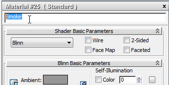

  4. Name the new material Smoke.

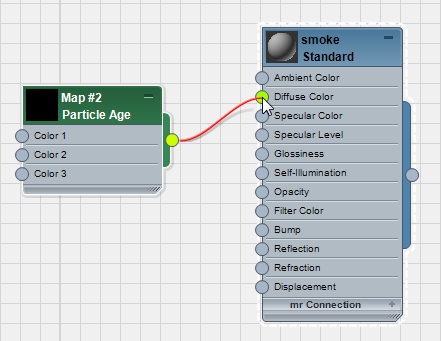

  5. On the Material/Map Browser panel, locate Maps Standard Particle Age, and drag the Particle Age entry into the active View.
  6. In the active View, wire the Particle Age map output to the Standard map’s Diffuse Color input.
  7. Double-click the Particle Age map node to display its parameters.

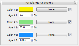

    The Particle Age map specifies three colors: By default, Color #1 is the color at a particle’s birth (0 percent), Color #2 is the color when the particle is halfway through its life (50 percent), and Color #3 is the color at the particle’s death (100 percent). You can change the ages, but we won’t do so in this tutorial.
  8. Change Color #1 to yellow, Color #2 to green, and Color #3 to blue.

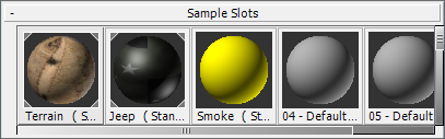

  9. In the Material/Map Browser panel, scroll so you can see the Sample Slots group. Drag from the output socket of the Smoke material node (at the right), and drop it on an unused sample slot. In the Instance/Copy dialog, choose Instance, then click OK.

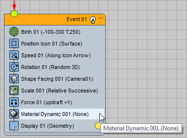

  1. Minimize the Slate Material Editor and restore Particle View (6).

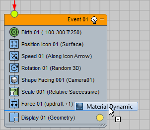

  2. Drag a Material Dynamic operator from the depot, and drop it on Event 01 between the Force and Display operators.
  3. Click the Material Dynamic operator to highlight it.
  4. In the Material Dynamic parameters, click the Assign Material button.
    3ds Max opens a modal version of the Material/Map Browser.
  5. Scroll to the Sample Slots group, and double-click the Smoke material.
  6. Hide Particle View (6).

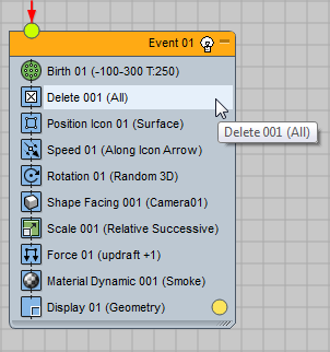

  2. In Particle View, drag a Delete operator from the depot, and drop it on Event 01 between the Birth and Position Icon operators.
  3. Click the Delete operator to highlight it.
  4. In the Delete parameters, choose Remove By Particle Age.
    Choosing By Particle Age enables the Life Span and Variation parameters.
  5. Change the value of Life Span to 350 and the value of Variation to 50.
    The Variation setting introduces a random variation in the life span of particles, so the system doesn’t appear too uniform.
